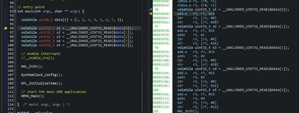

I have trouble with sporadic Hardfaults and I tracked it down to some unaligned access in the USB routines. Although the code uses the macro __UNALIGNED_UINT32_READ, the STM32 will still causes the Hardfault for unaligned addresses. So I looked at the disassembly and found that __UNALIGNED_UINT32_READ is translated into a simple "ldr.w" which, of course, traps on unaligned addresses.
Looks to me like __UNALIGNED_UINT32_READ does not work. I worked around by disabling the Unaligneded trapping, but any idea why __UNALIGNED_UINT32_READ does not work?

In stm32l4xx_ll_usb.c __UNALIGNED_UINT32_READ is used only to access the memory that is supposed to be "normal data". For example a buffer in memory.
CM4 can read and write unaligned 16 or 32 bit values in normal memory natively. GCC knows this and generates plain code without any tricks, even with __attribute__((packed, aligned))
Cortex M0 cannot do unaligned accesses natively so the compiler must generate code to work-around.
On the other hand, if __UNALIGNED_*** macros access device or strongly ordered memory on CM4, the compiler should generate workaround, but there's no way to let the compiler know this (?)
Also IIRC M4 and M7 have a SCB bit that can disable unaligned access so that the CPU behaves as CM0. If this is active, gcc is unaware about it as well.

I don't use Cube but it may well be that this macro works only for compilers which support code generation for deliberately unaligned accesses - and AFAIK gcc does not. Also, I was under the impression that the USB code in Cube in case of gcc does not rely on this macro anymore and there is a branch which explicitly splits the accesses. But as I've said, I don't use Cube and don't really care.

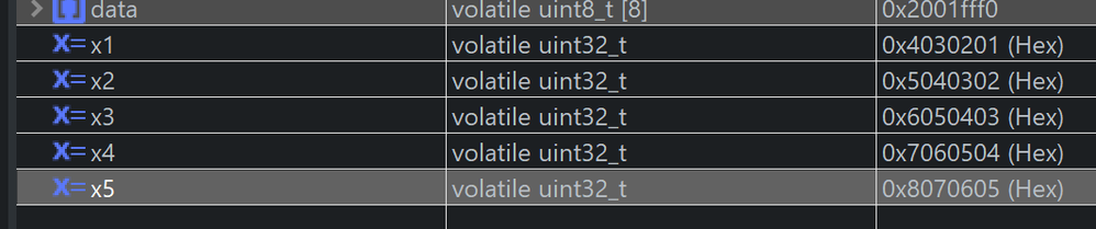

FWIW, I can't duplicate this on an F4. __UNALIGNED_UINT32_READ works fine on a STM32F429 with updated gcc.
As I've said, it probably doesn't work as expected (i.e. making compiler to split transfers) in gcc, only in IAR and Keil.
As Pavel said above, it's not"of course", on CM4 you have to switch off unaligned access support deliberately. So the question really is, why do you do that.
Or, are you sure the problem are unaligned accesses, and not something else.

Thanks for your answers.
Good question. I used to believe that there must be a good reason why unaligned access can trigger a HardFault (I remember that unaligned access can give undefined behaviour on some architectures)...
Okay, so I just don't enable the unalignment trapping and everything is fine, right?
@TDK:
I take it that you don't have unalignment trapping enabled?
