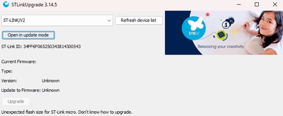

I have updated the STM32Cube IDE version to the 1.15.0, it has own STLinkUpgrade tool which is also updated to version 3.14.5. But a problem arised. It wants me to update my STLink V2 firmware. When I tried, It gives error like:
"Unexpected flash size for ST-Link Micro. Don`t know how to upgrade."

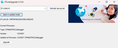

But I can use the older version 3.13.4 without any problem:
Is there a problem caused by 3.13.5 or caused by my ST-Link V2?

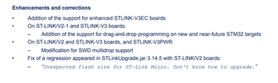

Summary: I tried with the latest ST-LINK Updater exe version 3.15.6 and my problem has been resolved.
Document: Firmware upgrade for ST-LINK, ST-LINK/V2, ST-LINK/V2-1 and STLINK‑V3 boards - Release note
It is happy to see my issue on fixes issues list.
The newer version of updater is not embedded on IDE yet. You need to download from here: STSW-LINK007 - ST-LINK, ST-LINK/V2, ST-LINK/V2-1, STLINK-V3 boards firmware upgrade - STMicroelectronics
2024-03-20 5:28 AM
Hello @mcagriaksoy
Can you give more details about the board/MCU that you are using.
Best Regards.
