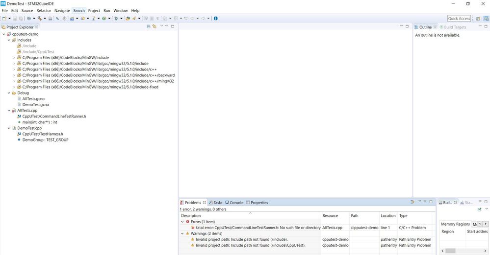

I downloaded the cpputest-demo and opened the project with STM32CubeIDE and got the message that it couldn't find "CommandLineTestRunner.h". I searched my entire disk and it does not exist. (See attached). The IDE just updated itself today, so it's the latest version.

The project is based on CppUTest, so it is needed to install CppUTest.
