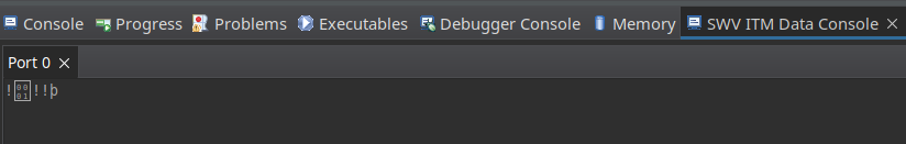

2023-06-10 3:48 AM - edited 2023-11-20 3:34 AM
just for fun...i tried on F303 simple test (program is only "blink LED" ;
tried with old st-link V2, this coming from console
should be: printf("clearScreen \n\r");
