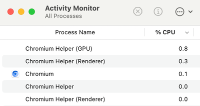

2024-06-05 2:09 AM
Has this been fixed in the 1.15 release? I'm running 1.15.1 (Mac) and I'm no longer seeing any Chromium threads using excessive CPU:

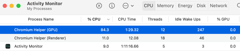

2024-06-14 2:12 PM
Just noticed a Chromium thread that was showing as "Not responding" in Activity Monitor (along with some others that were "normal").
I quit the IDE and ended up with 3 Chromium threads left running at 100% CPU after the IDE had terminated. These threads eventually terminated on their own, but two of them crashed leaving Crash Reports.
