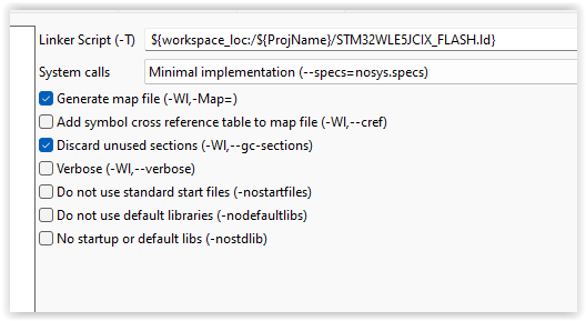

Ok, that is simple to try : when I do that, all the library stuff is still in the build.
Here are my linker settings..
Still, the Interrupt routines call HAL functions, so it may still be included from there..
I see that some of the LoRaWAN stuff uses printf statements for debugging, so maybe it's included from there...
