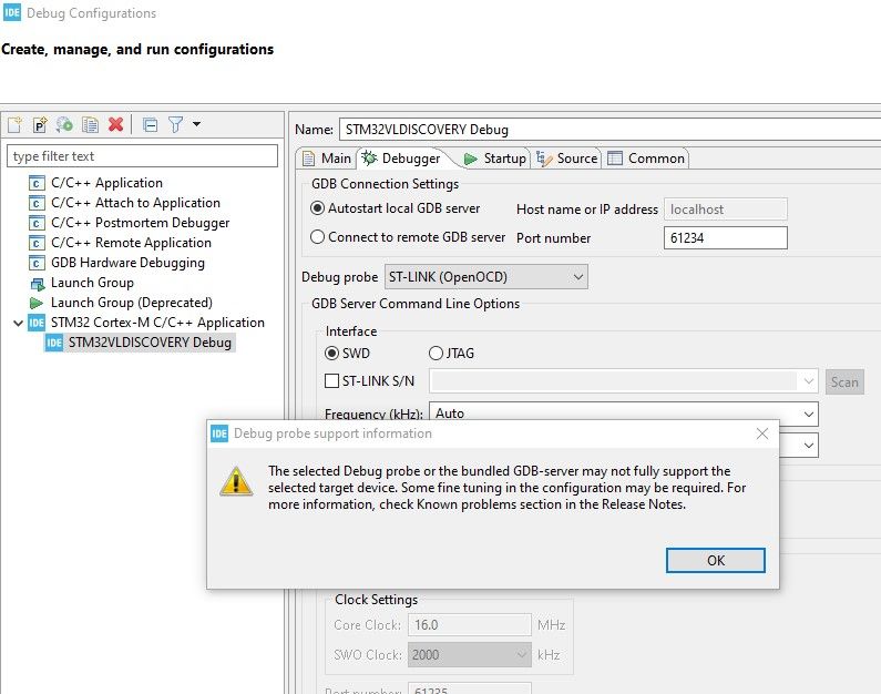

About 3 weeks ago, an update was received from ST that made both my Windows 10 and Linux boxes unable to connect to the VL Discovery. The message reads that I must plug in my ST-Link device.
The stlink Linux command line tool is still able to connect to and program the device flawlessly.

Peter BENSCH
Your board is the first DISCOVERY that appeared for the STM32 at the time and still contains version 1 of the ST-LINK, which is no longer available. All boards that were added later then used newer versions of STLINK, so that support for version 1 no longer makes sense.
The STM32CubeIDE uses the STM32CubeProgrammer for programming. Since the STM32CubeProgrammerno longer includes support for STLINK (V1), e.g. because of a completely different communication protocol, STM32CubeIDE can no longer support the STM32VLDISCOVERY either.

At debug phase I'm getting myself proper info about support lack if debug based on STM32F100 VL-Discovery

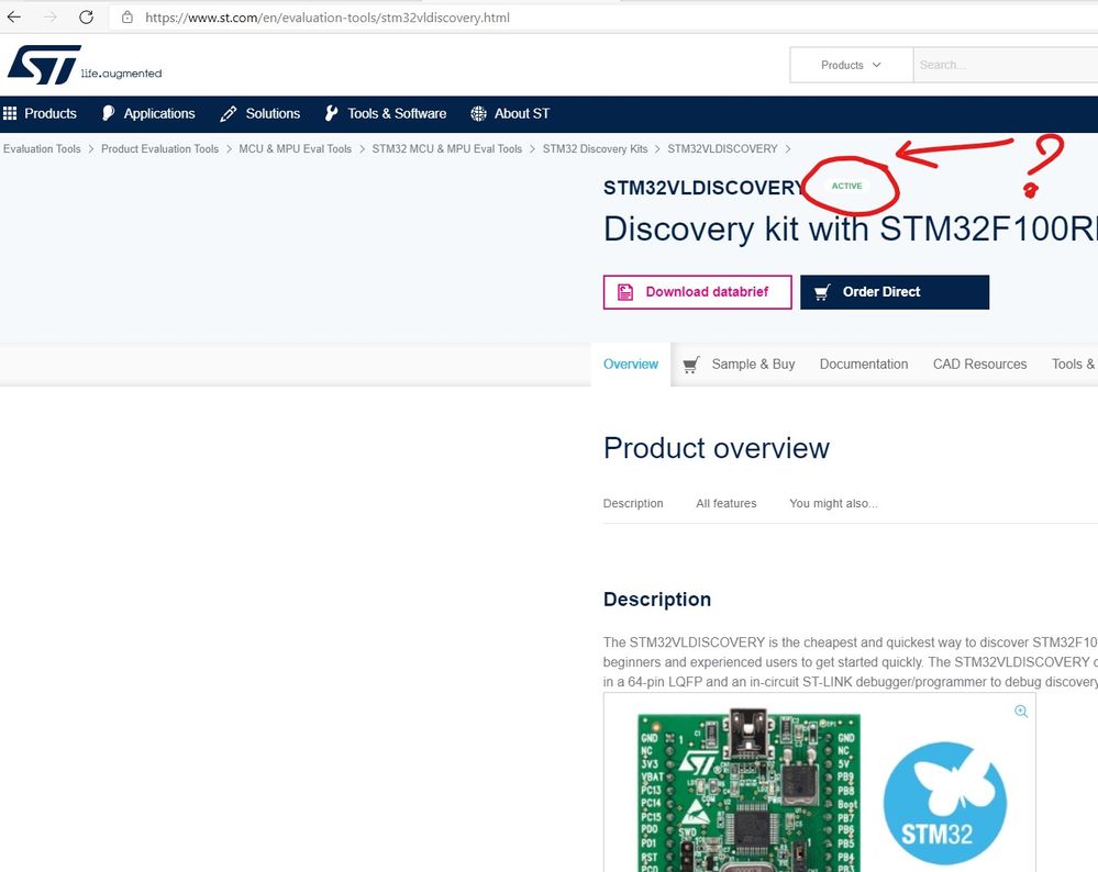

But @Peter BENSCH​  my pain is such board is set as active ... :sleepy_face:
To respond to your points:
  • the support for STLINK (V1) has been removed many years ago
  • no need to switch to another toolchain, as there is a solution: just connect an external STLINK/V2 or V3, but please also note the next point
  • workaround: don't use the Board Selector while creating a project for the VLDISCOVERY but the MCU/MPU Selector, choose the STM32F100RB and select the necessary functions manually, i.e. RCC (clock), SYS (Serial Wire debug), GPIO (button, LEDs). Just tested: debugging and programming works fine.

Hi, @Cartu38 OpenDev​
for debugging using STM32CubeIDE please see my comment above.
For the availablity of the STM32VLDISCOVERY: active means Product is in volume production. And yes, debugging/programming is possible if you use an external debugger, e.g. an STLINK/V2-1 from a NUCLEO or other DISCOVERY.

I just tried this for the fun and it works: https://visserslatijn.wordpress.com/2019/01/20/upgrade-st-link-v1-to-v2/. However, the flashed firmware of the VLDISCOVERY programmer must be updated afterwards with the STM32CubeProgrammer to be fully usable.
As indicated by Peter above, the project must be created for STM32F100RB to avoid the "Debug is not supported" message. However, to get the .ioc file, just create an empty VLDISCOVERY project with the MCU/MPU Selector, then copy the .ioc file to the STM32F100RB project and rename the .ioc file.
