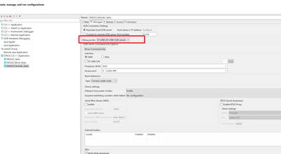

I have created a project by simply performing copy and paste. I copied 002LED_Tasks and pasted onto project explorer, then rename it as 004LED_Periodic_Tasks.
When I debug the 004LED_Periodic_Tasks, debugger debugs the 002LED_Tasks.
Please find attached images.
Could you please point me to the right direction in which I can resolve this problem ?

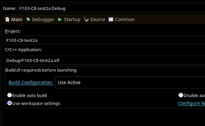

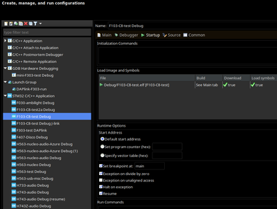

Just look in your debug configuration -> settings, what file is used for debug (and change it...):

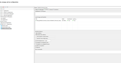

seems like problem is not about that, please see below. What could be the root cause ?

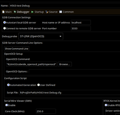

Hmmmm.....if you use openOcd, there is another path -> script file to change:
2024-02-27 6:19 AM
No I didnt use open OCD. I suspect it is about the makefile.

....and i debug setting main : correct elf file ?
2024-02-27 7:53 AM
Unfortunately elf file is correct.

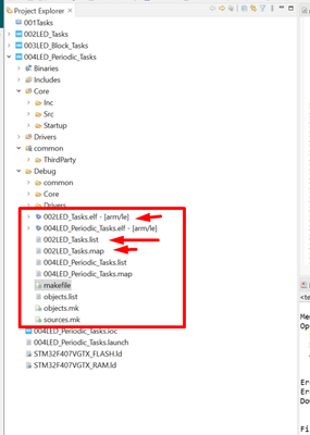

I believe, there is something causing these files to be generated under Debug folder. What could it be ? any idea ?
