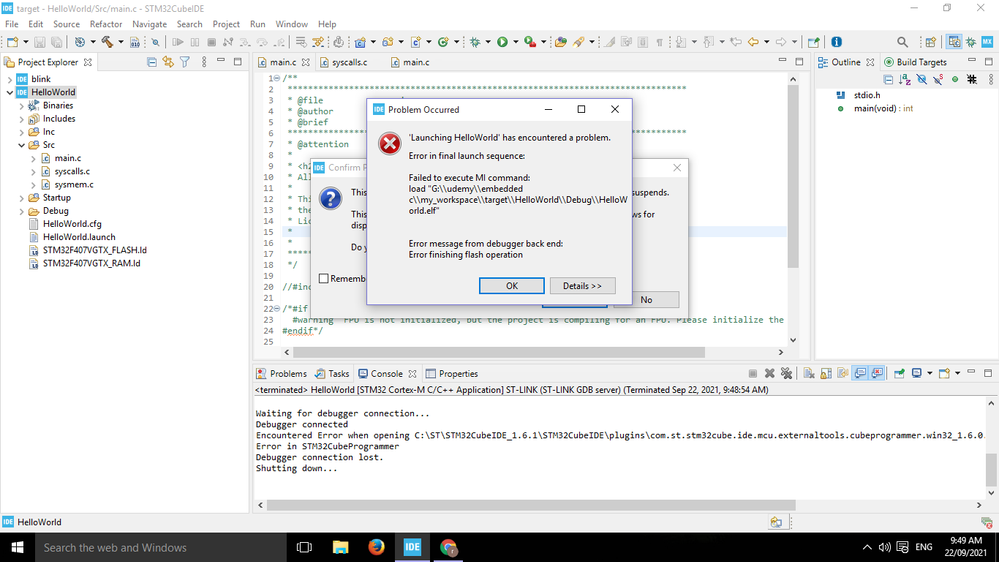

when i am debugging "Hello World" program to target board (Failed to excute mi command:load)
RNaga.4
Associate
Failed to execute MI command:
load "G:\\udemy\\embedded c\\my_workspace\\target\\001HelloWorld\\Debug\\001HelloWorld.elf"
Error message from debugger back end:
Error finishing flash operation
Error finishing flash operation  ""
2. here is console output    ""  STMicroelectronics ST-LINK GDB server. Version 5.8.0
Copyright (c) 2020, STMicroelectronics. All rights reserved.
Starting server with the following options:
    Persistent Mode      : Disabled
    Logging Level       : 1
    Listen Port Number     : 61234
    Status Refresh Delay    : 15s
    Verbose Mode        : Disabled
    SWD Debug         : Enabled
Waiting for debugger connection...
Debugger connected
Encountered Error when opening C:\ST\STM32CubeIDE_1.6.1\STM32CubeIDE\plugins\com.st.stm32cube.ide.mcu.externaltools.cubeprogrammer.win32_1.6.0.202101291314\tools\bin\STM32_Programmer_CLI.exe
Error in STM32CubeProgrammer
Debugger connection lost.

I did not use spaces, umlauts and other "difficult character " for the path of my project. but still this problem occurse. please help me for this.
Hmm,
you did in the above screen dumps.
definitely containes a space char " ". If you have changed that, show the new error with its Details.
