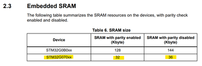

The explanation of 32 vs. 36 KiB may be found in the Reference Manual. The software uses the linker-defined _estack symbol as stack bottom location. You may reconfigure the MCU and edit the linker file to change the amount of RAM available to software to 36 KiB.
Correction: This is supervisor mode stack in no-OS environment. User mode stacks are normally used by RTOS threads only.
2024-02-14 11:06 AM
In this case, the SRAM size depends on if you have parity enabled or not.
If it is disabled, you have 36 kB. If it is enabled, you have 32 kB.
Parity is enabled/disabled in the option bytes, which you can access with STM32CubeProgrammer.
As @gbm mentioned, _estack is the top of the stack, and memory gets allocated starting just below that point.
