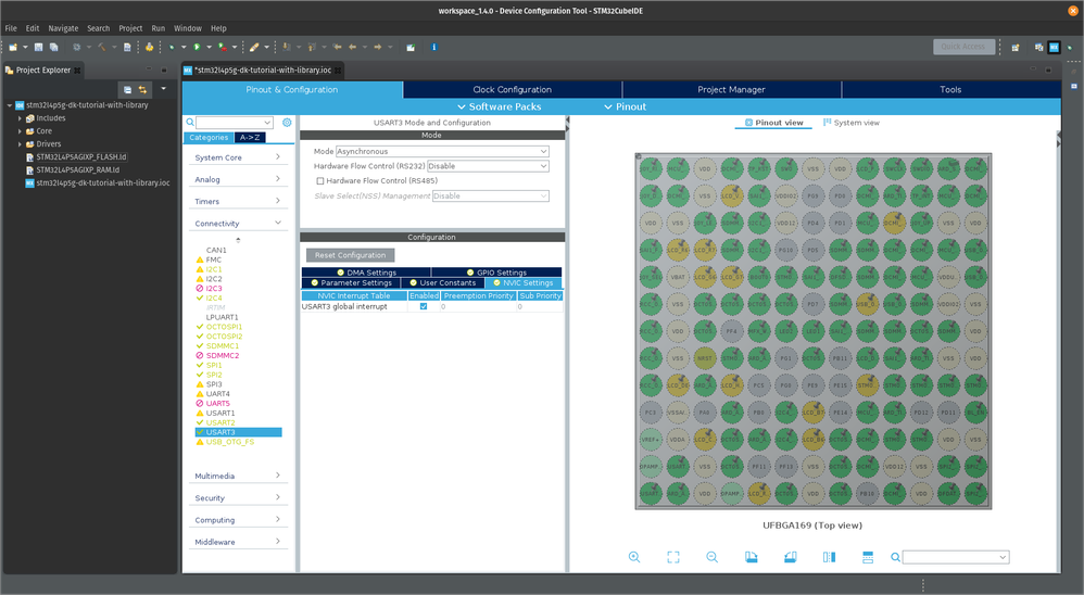

However, I am having difficulty when I attempt to enable USART3 (available on the expansion board) for use with my project. I resolve the conflicts (warnings) and get the "green checkmark" (as I did with the other peripherals), but when I look at the pins on my oscilloscope, there is no activity. What gives?

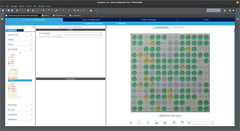

Here is the Device Configuration Tool view:

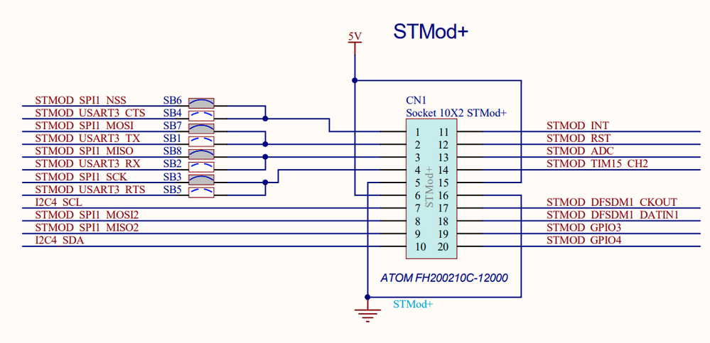

Did you close the necessary solder bridges?
Also seems like you still have SPI1 in use, which will fight for the same pins as USART3, unless you've changed them.

I'll hunt for the solder bridges, but if you're up for it, I would still appreciate a pointer. In the meanwhile, I've attached my NEW pin configuration, in case you can see any other obvious problems.

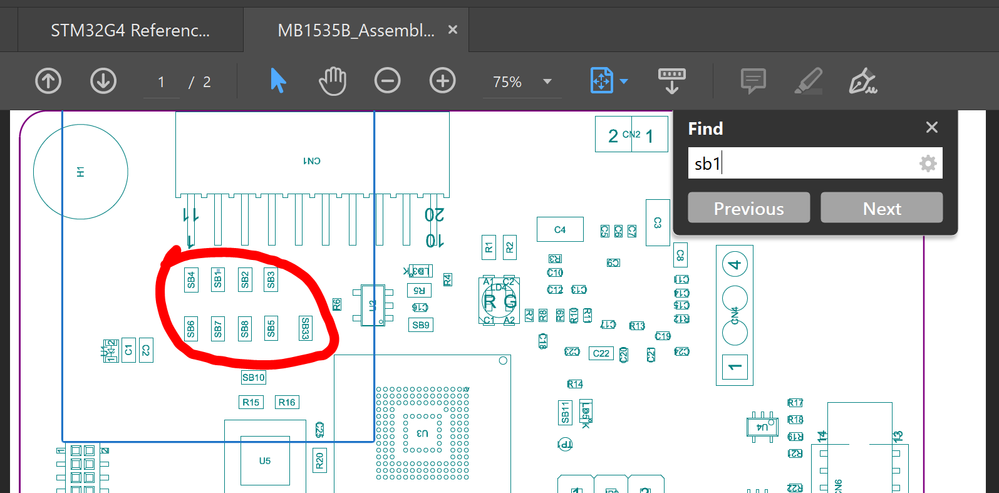

> Where are they located on the STM32L4P5G-DK?
The bridge should be labeled on the board. Might take a minute but just looking for it is probably the easiest way. If you get really desperate, you can download the board manufacturing files and Ctrl+F for it.
> Also, what documentation are you referencing?
The schematic and other stuff are available under documentation on the product page. There is also a user manual, although it didn’t mention the solder bridges at all as far as I could see.
https://www.st.com/en/evaluation-tools/stm32l4p5g-dk.html#documentation
> Finally, why doesn't the STMCubeIDE report the pin conflict?
CubeMX has no idea the pins are tied together (via solder bridges) on the board, so it doesn’t know there’s a problem to report.
