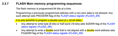

2023-07-31 10:00 AM
Per the reference manual, the STM32C0 series can only program double-words in flash. Writes less than that will fail.
2023-07-31 10:00 AM
2023-08-07 2:01 PM
Also there is no FLASH_TYPEPROGRAM_WORD defined in HAL:
Therefore it's not even clear how the code is compiled in that case.
