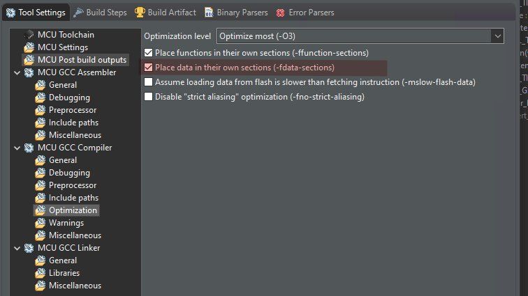

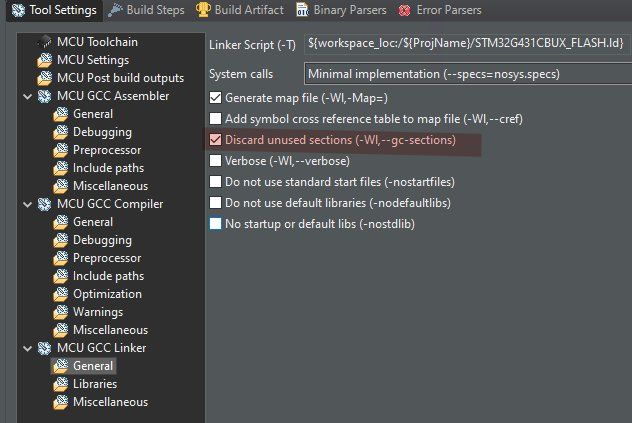

The 'used` attribute is working exactly as intended. If you remove the  "--gc-sections" linker options, the variable will appear in the output.
The default linker options for Cube projects (helpfully) include "--gc-sections". Which means you've asked (*) the linker to prune the variable (to the linker, this is just an unused section). This also, is exactly as intended.
I suggested `retain` as a workaround since you could have used to achieve your goal. Unfortunate that it isn't supported as you rightfully pointed out.
You could certainly ask ST OLS for advice on how to achieve your goal. I can suggest one as well:
- remove "-fdata-sections" from the compilation flags. Be aware that this may result in a larger final binary (**).
