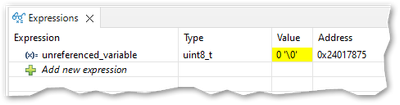

According to the manual , "This attribute, attached to a variable with static storage, means that the variable must be emitted even if it appears that the variable is not referenced."
In the following code, unreferenced_variable is always discarded:
static uint8_t unreferenced_variable __attribute__((used));
There's no warning from the compiler.
  1. Is 'used' supported in principle please?
  2. Is there a problem with the syntax?

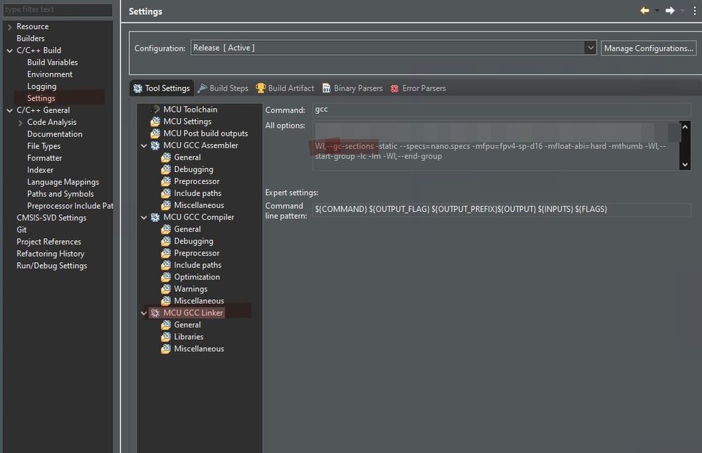

By default optimized builds are compiled with `-ffunction-sections -fdata-sections` options and linked with the `-gc-sections` option. So, in all likelihood, the unused variable is preserved by the compiler (not optimized away) as AScha.3 explained (i.e. it's present in the .o file), but is then pruned away at link time (i.e. it's eliminated from the final .elf file).
This is a very good thing to have on by default for optimized builds since it significantly reduces binary size, and space is usually a scarce resource in embedded systems.

3. ...Unless you specifically ask the linker to gc unused sections  (and used -fdata-section during compilation),
 in which case the variable will not be included by the linker in the final output elf file.
4. ...Unless you annotate the variable with the "retain" attribute, in which case the linker GC will skip over the variable, and it will be emitted in the final elf file.
