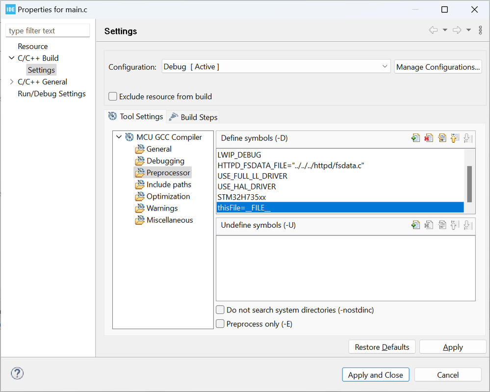

I want to automatically add the following line of code at the top of each source file within my project:
static char const thisFile[] = __FILE__;
For this, I'm creating the following Define symbol (-D) in STM32CubeIDE, by going to project Properties -> C/C++ Build -> Settings -> Tool Settings -> MCU GCC Assembler -> Preprocessor:
However, when I click on OK -> Apply and Close, it shows this warning, which I don't completely understand.
Anyway, I click Rebuild Index, and it changes my symbol by removing the semicolon at the end and adding some new double quote symbol "
and, when I build the project after this (the code already uses thisFile string in its functions), it throws this error:
error: 'thisFile' undeclared (first use in this function)
I suspect, that it happens because the preprocessor can't properly transform the semicolon from my symbol, so the whole static char const thisFile[] = __FILE__ line becomes invalid.
Is there a way how to make this Define symbol (-D) feature to work with semicolons or maybe some other way how to add my desired line of code at the top of each source file?

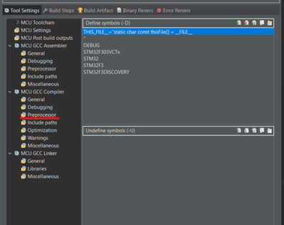

@pav_ivanovs wrote:For this, I'm creating the following Define symbol (-D) in STM32CubeIDE, by going to project Properties -> C/C++ Build -> Settings -> Tool Settings -> MCU GCC Assembler -> Preprocessor:
you are creating a #define for the "MCU GCC Assembler". do it in the "MCU GCC compiler" section instead.
2024-04-26 12:40 AM
Ok, I've added the same symbol there, but the result is the same
2024-04-26 12:49 AM - edited 2024-04-26 12:58 AM
Is there an error reported by compiler ?
I suggest to remove the double quotes. Especially the double quote that is on the second line.
In your C code, how do you use THIS_FILE__ ? I suggest to add a semi colon after THIS_FILE__ on a single line:
THIS_FILE__;
Try to find in the CDT build console what command line is really used ( "arm-none-eabi-gcc c:/path/to/file.c -DTHIS_FILE=...")

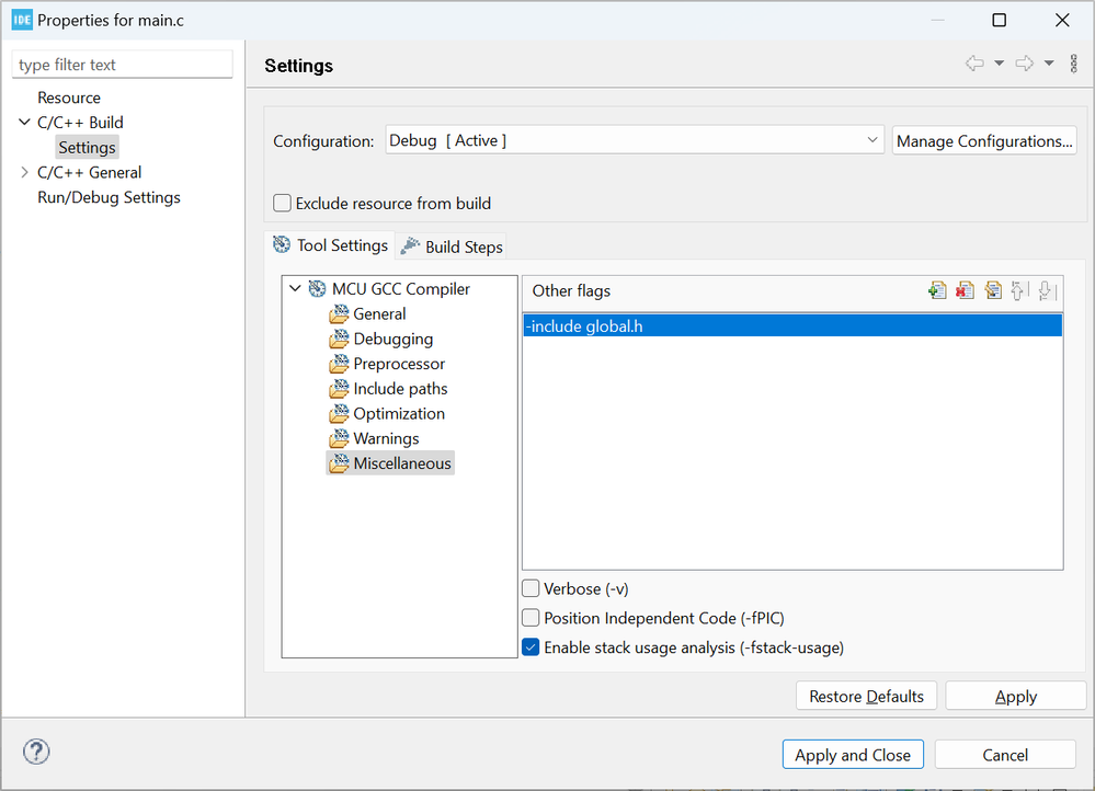

I have a better solution. Use the -include command to force include a file in all source files without modifying the files. You will need to create one header file.
global.h:
#ifndef GLOBAL_H_
#define GLOBAL_H_
#define thisFile __FILE__
#endif // GLOBAL_H_
And in my main.c:
SerialDebug("%s\r\n", thisFile);
