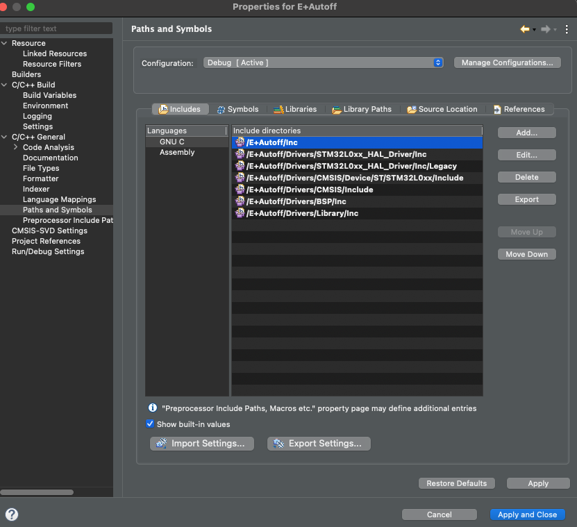

3.add library path to
"Properties -> C/C++ General -> Paths and Symbols -> Includes ->GNU C"

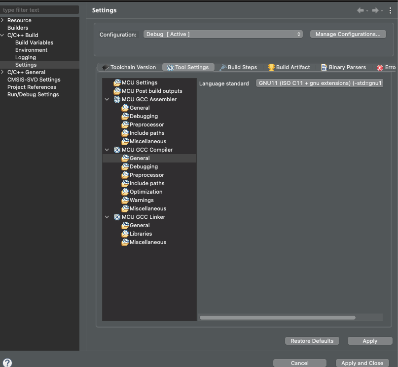

and follow this article i check my project ids using GNU11
https://community.st.com/s/question/0D50X00009Xka2a/weak-clang

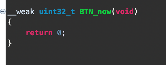

but I got the error message after Building project
../Drivers/Library/Src/button.c:232:1: error: unknown type name '__weak'
../Drivers/Library/Src/button.c:232:17: error: expected '=', ',', ';', 'asm' or '__attribute__' before 'BTN_now'
make: *** [Drivers/Library/Src/subdir.mk:24: Drivers/Library/Src/button.o] Error 1
make: *** Waiting for unfinished jobs....
can some help me that , thanks

The error message is misleading. __weak is compiler specific, syntax may vary among compilers. You may search in STM32CubeIDE generated code how the syntax should look like and imitate for your code. Maybe showing a little more code could help.

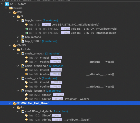

2020-12-13 10:48 PM
Perhaps your compiler demands "__attribute__ ((weak))" ?
2020-12-13 11:39 PM
There is probably only a macro used which is defined in HAL and related to __weak. Look it up in our code by using the search, goto definiton etc.. functions of the IDE. You may also check the compilers manuals about weak.
weak allows overloading functions at the linker level, roughly comparable to virtual member functions in C++.
2020-12-14 5:45 AM
Hi Ozone , KnarfB
Thank a lot for helping
I finally fine the define of weak function in STM32L0xx_HAL_Driver
and after define __attribute__((weak)) , this problem was solved

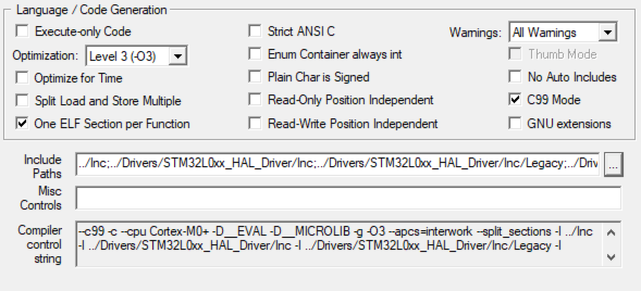

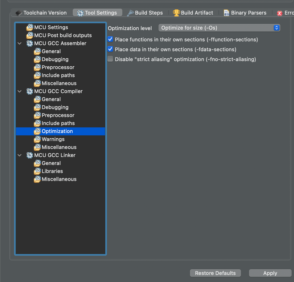

I find another interesting problem about code size,
same project between KEIL and STMcudeIDE have huge different code size
I try solve this problem by this article
If i solve it , I will tell you that
B.R.
In Cube ide
In Keil
