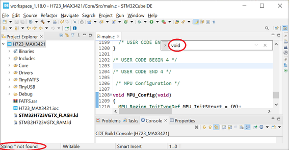

2025-03-03 6:26 AM
"Find next" seems to be broken in CubeIDE 1.18 (Running on Windows 10).
I remapped the "Find next" function to F3, and cancelled all other functions using F3.
Now pressing F3 seems to look for an empty string. Luckily the arrow up and down in the search box still work.

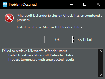

2025-03-04 1:45 AM
I get this annoying message everytime on startup (we don't have defender but other Antivirus)
On top if I checkout a project under revision control, that was updated to 1.18.0 on a second PC and import the project and try to build / clean build it I get a "nothing to build"
Error Message.
Any ideas / timeframe for a fix?
2025-03-04 2:18 AM
Sorry the build problems was my mistake, the Defender PopUp still is annoying

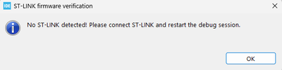

2025-03-12 8:16 AM
my nucleo l476RG board with integrated 2.1 st-link debugger does not work with 1.18
i updated the server and st-link drivers manually already but cubeide always says "no st-link detected" when i try to debug
But cubeide sees my debugger, i can update the debugger via help -> ST-Link upgrade
and i can flash my hex manually via st-link utility
