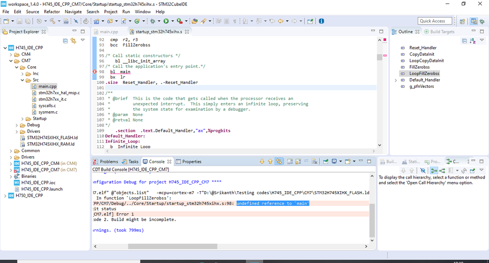

I am trying to convert c project to CPP in STMCUBE IDE,
Now I generate the code to STM32H745(Dual core) and convert to CPP by using convert to CPP option in CUBE IDE.
I am getting following error
undefined reference to `main'. (check in attached screenshot)
But same way I generated code to single core MCU, I did not get this error.
Now how can I resolve this issue.
2020-12-29 12:54 AM
Check that you have converted both sub-projects CM4 and CM7 to C++ and make a clean build. Works here with STMCubeIDE 1.5.1.
The term "convert" is IMHO misleading, it only changes the tool chain settings to enable C++ compilation.
