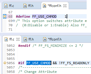

If you scroll up in the ff.c you have a define #if FF_USE_CHMOD && !FF_FS_READONLY that in my case were defined in a way that this part of the code were not implemented. I had to switch FF_USE_CHMOD to 1 on ffconf.h
I hope it helps
