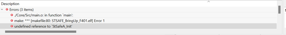

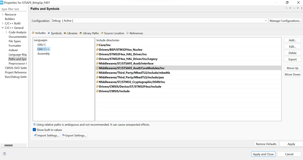

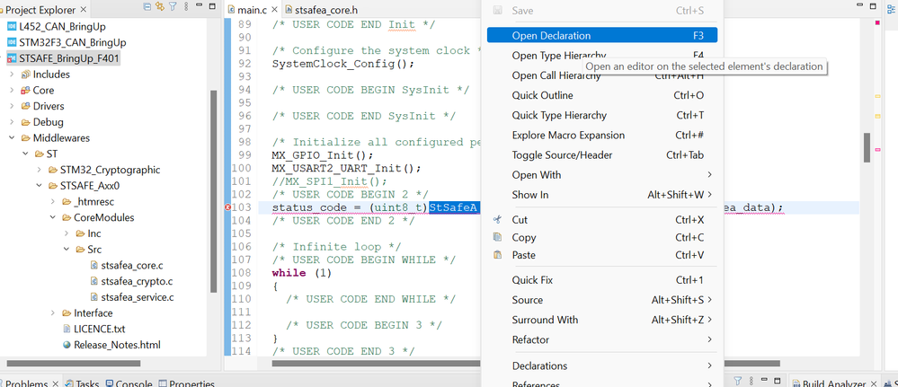

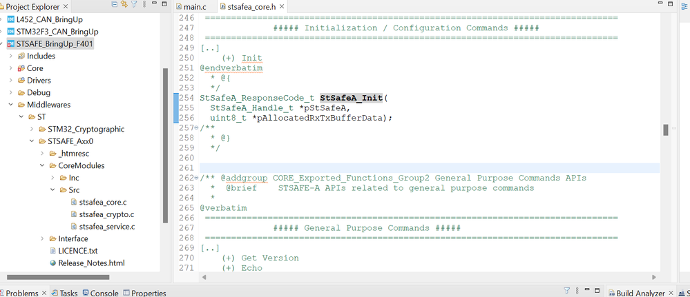

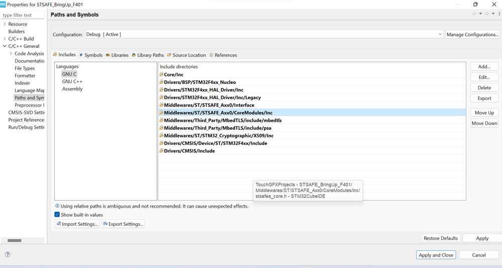

I am using the STM32CubeIDE to write software to test the STSAFE (Nucleo-F401RE + Nucleo-SAFEA1). I am trying to get a basic software working and trying to use one of the STSAFE functions, but I am running into a strange error when I try to compile it. Based on all the searches I've done, this is typically a linker issue. However, I verified that the file that declares this function.
I think I'm getting tunnel visioned, but I cannot see what part I haven't linked properly. Does anyone know where else to look?
