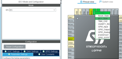

Trying to use I2C1 with REMAP=0 and as long as understand the SCL and SDA pins are PB6 and PB6. Along with I2C I am using some other peripherals as well. I am unable to select PB6 for I2C SCL PIN. Please see attached screenshot. Not sure why it wont let me select that default PIN. I am quite sure I am not using any other MASKED function for this PIN.

2024-10-25 4:34 AM - edited 2024-10-25 4:37 AM
If you select 'I2C under "Mode", the pins will automatically be selected.
2024-10-25 4:51 AM - last edited on 2024-10-25 6:45 AM by Tesla DeLorean
Hi Rob,

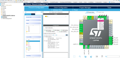

I do expect the same behaviour, but as soon as I enable I2C1, the REMAPPED pins are selected automatically. Please see the screenshot...
2024-10-25 5:32 AM
Hello @technofection and welcome to the ST Community.
Please add your .IOC file here so I can check. It works fine on my side.

2024-10-25 5:46 AM
Hi @STTwo-32 Here is the ioc file ...
