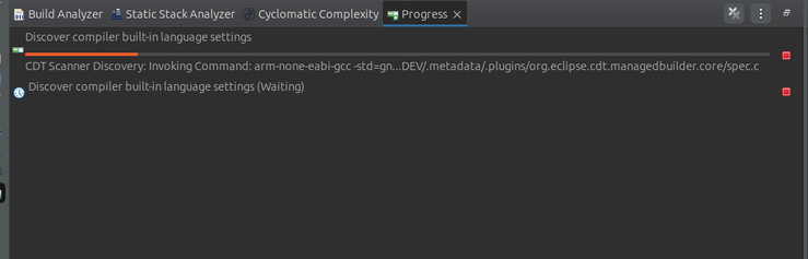

Starting make or clean. Happens with 1.15.1 and 1.16.1. Just recently updated to Ubuntu 24.10 (from 23.10) and seems to happens after that update. Just fresh installed IDE 1.16.1 because the "update" feature (link in update sites) seems (sometimes) broken or not working in 1.15.1
You may see the following :
it seems progressing then it my jump back in progress %
Cancelling the "discover language settings and it start the build, but it stuck at make and nothing happens.

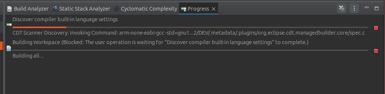

it stops at the same file as posted here:
https://www.eclipse.org/forums/index.php/t/1089926/
make clean and the result is the same
I tried these settings, the discovery blocking is gone, but make stops as above picture
