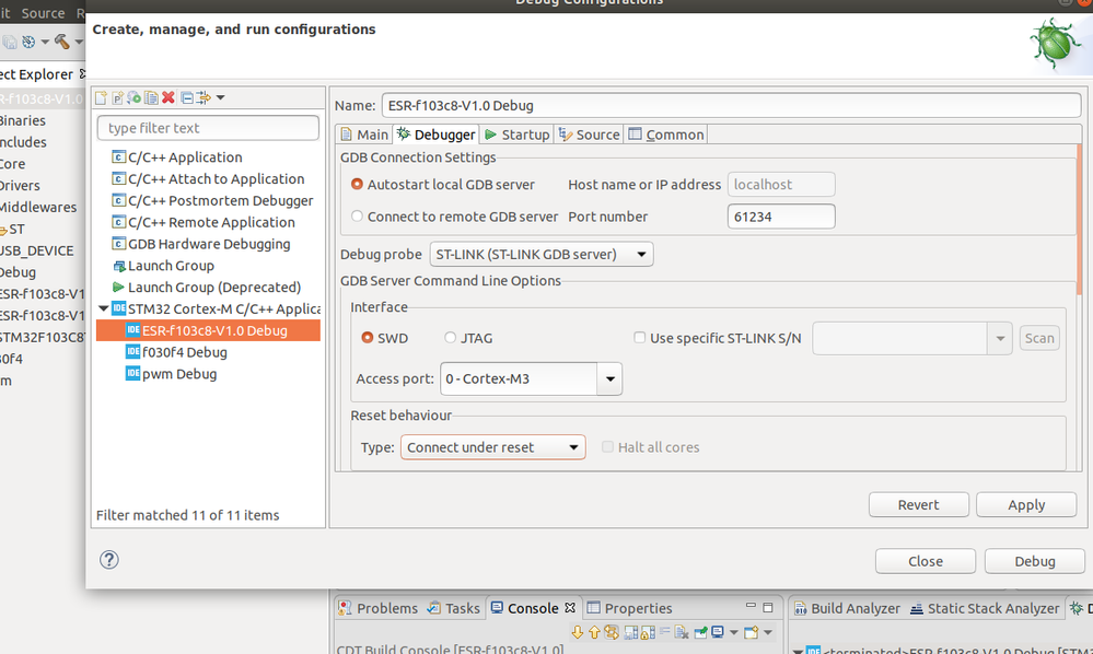

2019-12-26 10:18 PM
2019-12-28 2:49 AM

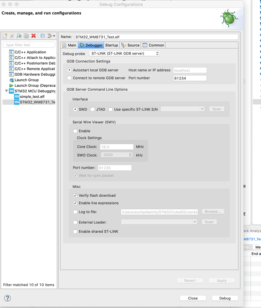

Thanks for doing that! As far as I can tell I have this setup correctly, and it appears to match one of my working projects. The config in the .ioc looks the same as yours, but my 'Create, manage, and run configurations' looks a bit different, screenshot attached
