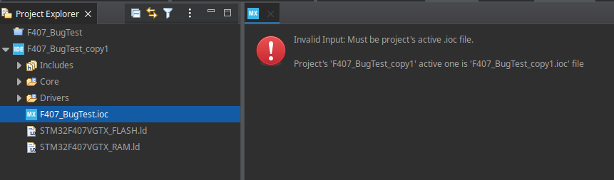

Hi, I noticed that it is not possible to copy the project and then try to open the IOC file. Causes this error:
Invalid Input: Must be project's active .ioc file.
Project's 'F407_BugTest_copy1' active one is 'F407_BugTest_copy1.ioc' file

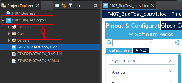

But if the name of the IOC file is changed manually, with the same name as the project, then no error occurs:

the project name is name of (top) folder and associated ioc file.
you CAN copy this, but afaik all operating systems not allowing same name for a copy - so you change name of project (= top folder) and then need to change ioc name to same...whatever name now.
