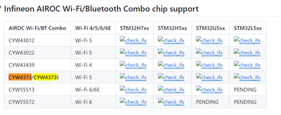

After checking the Infineon/AIROC github repo you can see that the STM32L4 series of MCUs including STM32L4R9 are not supported for your module.
