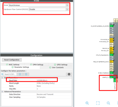

2024-03-01 10:26 PM
You have only one uart, but you initialize it twice:
MX_USART2_UART_Init();
/* USER CODE BEGIN 2 */
SEGGER_UART_init(250000);Note that "MX_USART2_UART_Init()" has initialized the uart with baudrate 115200.
Then "SEGGER_UART_init(250000)" does this again but with baudrate 250000.
Delete the call to SEGGER_UART_init. And try again.

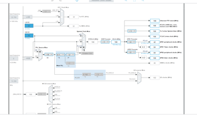

Either you have the settings wrong for baud rate, or wrong HSE_VALUE
For strings use strlen() or sizeof()-1 to not send the NUL over the wire
2024-03-01 10:02 PM
I am using HSI as shown in below image.
The baudrate should also be OK.
I am using FreeRTOS in my application. May it be causing the issue ?
