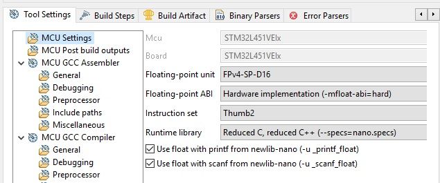

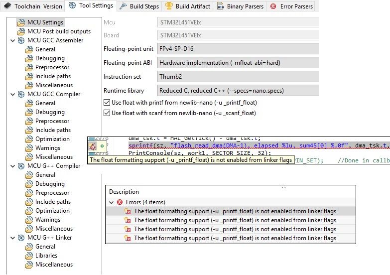

The float formatting support (-u_printf_float)is not enabled from linker flags
I can't find Linker flags/Options/Settings for C - just for MCU G++ Linker. When I chose the option, it still didn't remove the error. It compiles, though and can be run.

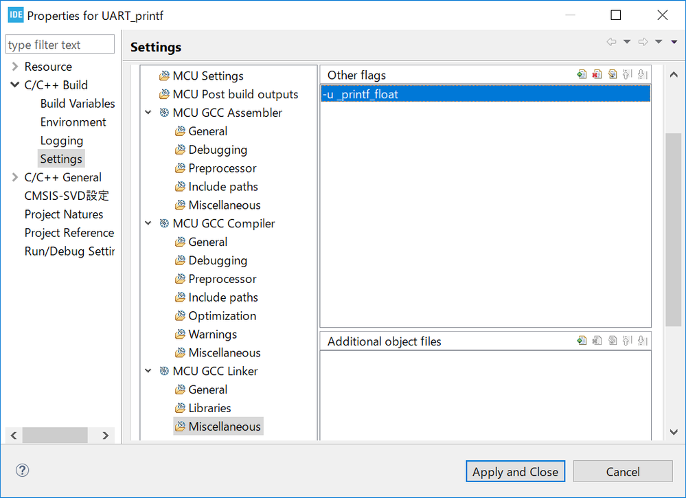

This problem is fixed in STM32CubeIDE ver.1.0.2.
Workaround in older version is to add "-u _printf_float" to MCU GCC Linker -> Miscellaneous -> Other flags.

Even after I choose the settings, I get the error...

In the linker command I see that -u_printf_float is defined - and still I get the errors that printf doesn't support float!!!

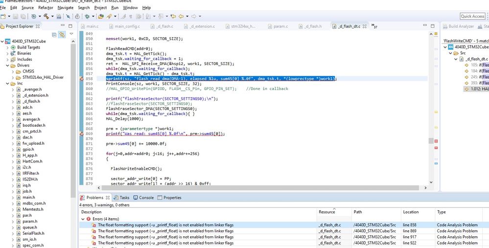

" It compiles, though and can be run" So it is a build error or not ? It's not clear. And can you printf float variables at the end ?
I checked on a project of mine and there is indeed an error message in the Problems tab. To be honest I never look at this tab and I'm not sure it is reliable in this IDE.

As you've seen yourself - these errors are mentioned, but the project can be debugged.
