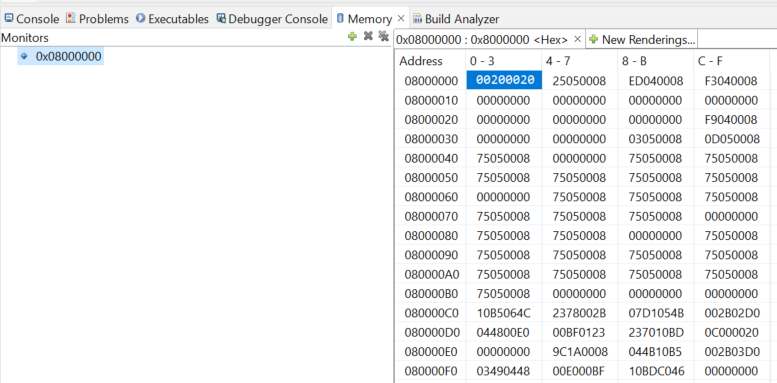

I've used Keil for the last year - and they have a feature where I can view the flash memory while debugging (and even change it)
I can't seem to find that with CubeIDE. Is there a way to see flash memory? I want to read/write and confirm it's there, etc.
2022-12-09 8:18 AM
Window-> Show view-> Memory and Window-> Show view-> Memory Browser
2022-12-12 6:53 AM
Hello jgauthier,
Thank you for posting your question!
In order to debug flash memory you can add your flash address in the memory browser window.
This screen shot may help you.
