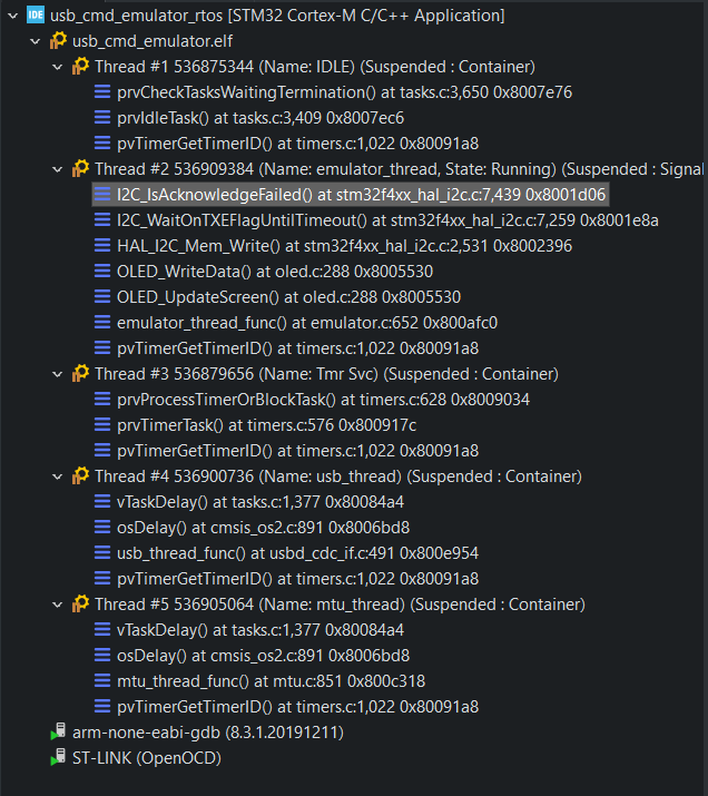

I'm using STM32CubeIde 1.4.2 for Mac OS. I've managed to configure FreeRTOS debugging on STM32F4 MCU but I can't get it working on STM32G071RBT. This is what I get in debug view:
It won't stop on any breakpoint. Does anybody managed to get FreeRTOS threads debugging on STM32G0? What can be the cause of this?

@Brian TIDAL_O you're kidding right? The issue still exists in 1.6.1
For FreeRTOS only RTOS-aware viewers have been added (Task list, Timers, Queues and Semaphore) - while no thread-aware debugging has been introduced (when you can simultaneously view stacks of all threads).
Please don't desinform people.
While the hack above works only with OpenOCD w STLink, it does not support STLink GDB Server yet.

2021-04-14 1:08 PM
Yes, you are right, but this whole forum thread has been dedicated ONLY to thread-aware debugging in a sense that you need to simultaneously view stacks of all threads, that's why your post might confuse newcomers. Information in the posts above is still relevant, problem is not solved by updating to 1.5.0+ (which a newcomer might think from your original message)
