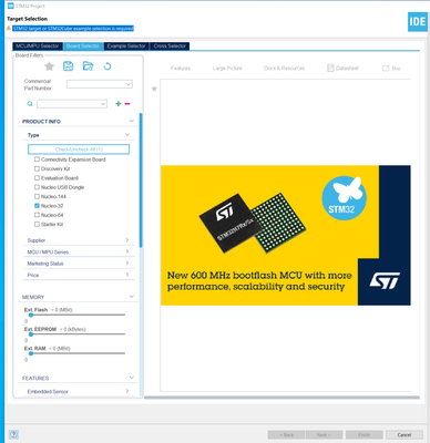

2024-07-15 6:39 PM
I'm getting the same problem on Window10.

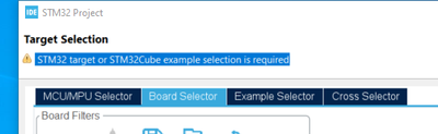

This is at the top of the screen
And as you can see below, there are no boards to be selected from.
If I go back to the select by MCU/MPU instead of by board and already know what specific board I want, I can then click on the board as an option.
Also this only happens when I try to start a new project from inside STM32CubeIDE. When I open CubeMX directly, the board selection tool works properly.
I know the work around for this, but is there a fix, what should I be reloading?
