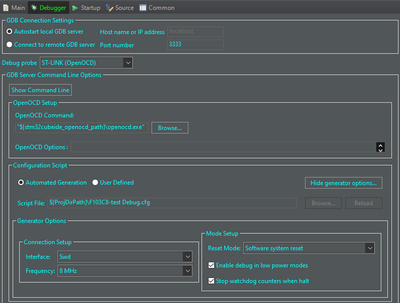

Did you set. enable debug ...low power ?

And yeah, I enabled to debug in low power modes as well.

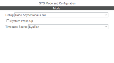

So : did you set/enable debug in Cube/ioc ?
If you set the swd/swc pins to another mode (like analog...) it will break the debug connection.
Set debug on the ioc .
