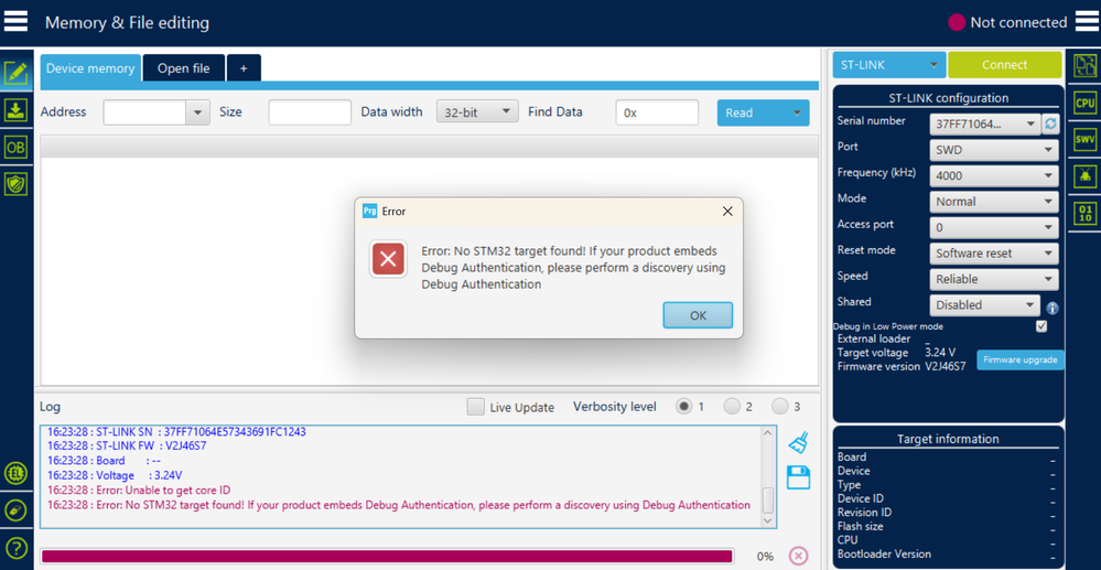

I made my own PCB, but when I connected 3V3, GND, SWDIO, and SWCLK using the ST-Link V2, the ST-Link is recognized, but my board is unresponsive.

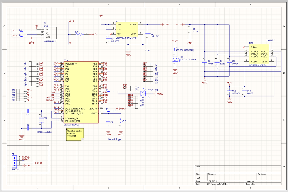

Is the chip oriented correctly? Pin 1 is bottom left when text is oriented normally from left to right.
MIC5504-1.8YM5-TR is a 1.8V regulator, not 3.3V.

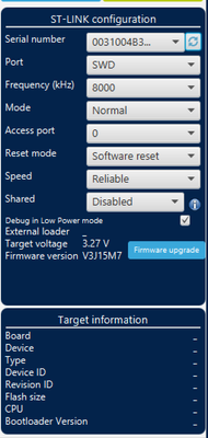

Does ST-Link report the target voltage correctly? Show a screenshot of this area:

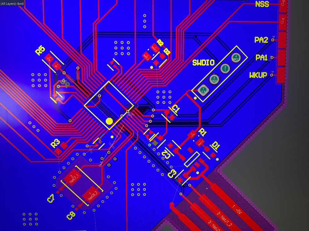

Thank you for your reply! I am very sure that the chip is oriented correctly. Yeah you're right, I don't know why I bought this LDO, but still, the ST Link 3V3 power shouldn't go through the regulator, it should directly power the chip. (the tangling trace was caused by removing the GND plane so I can show you the PCB's bottom layer)
I also tried pulling NRST low while pressing connect (Mode to under reset) and releasing the pin immediately after. But it didn't work.

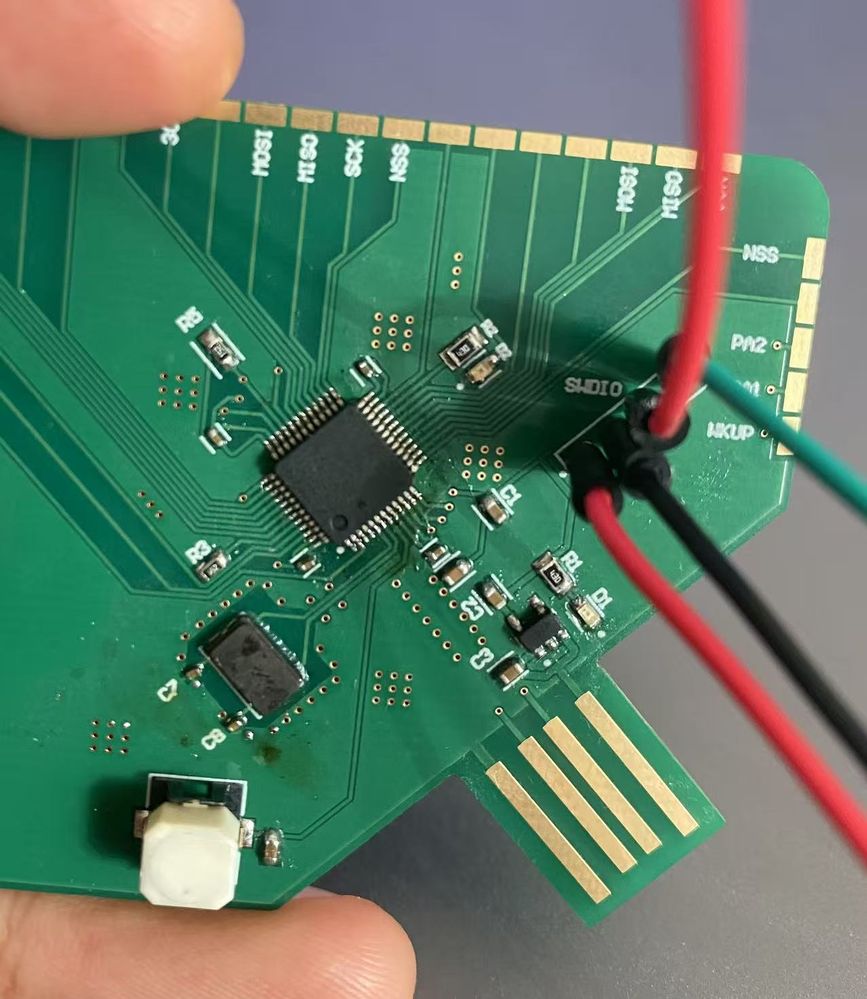

Can you take a picture of the chip soldered on the board?

I just came across this video, and he briefly mentioned that ST made an update, and the small ST Link V2 is no longer supported? -> https://youtube.com/shorts/LWoxFclaius?si=fEtbUIA73EZwjpcN
I'm using this: 1,333 × 1,000

The knock-off ST-Link V2 has never been officially supported but tends to work. It's clearly being recognized here.
A few things could be causing issues:
I'd recommend a real chip from a reputable supplier and a real programmer. They're relatively inexpensive.

My f103CBT6 does have markings, but the markings don't come in white, they are almost blended into the chip? But I assume it's legit, since I bought it from Digikey. So, based on what you've seen, does the PCB design seem alright? I will definitely use another programmer and will double check the wirings. Thank you so much.

Yeah, it's probably legit then if it's from Digikey. Weird how the markings don't show up at all in the picture.
There's also a little mark near pins 5-6 that might indicate the magic smoke escaped somehow. Hard to tell without a better picture.

You need to do a lot better with the picture.
Perhaps a better camera, but definitely more resolution, tighter zoom and in-focus. Perhaps try macro mode. Should be a lot better with a 5+ MP cell phone camera
TBH it looks like the device may be rotated 180 degrees, and what you think is the pin one is in fact a injection mold port, and there is a more subtle detent in the top corner.
With normal readable markings the pin one mark should be in the lower left
STM32F
103CB
ARM
O <-- pin 1
If the orientation is correct, the next most likely is some kind of power issue, or connection to the wrong pins. The error suggests the part is not viable as placed / built
