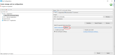

For the "Run" button:
  • Go to Run > Run Configurations then select your project under C/C++ Application.
  • In the Main tab, find the section Build (if required) before launching.
  • Click on Select Configuration and choose Release.
  • Click on Apply then on Run.

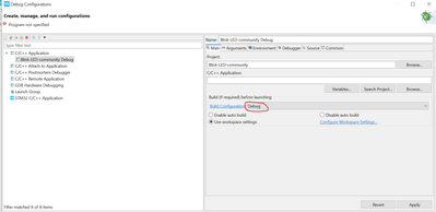

For the "Debug" button:
  • Go to Debug > Debug Configurations then select your project under C/C++ Application.
  • Click on Select Configuration and choose Debug.
  • Click on Apply then on Debug.

This is what I already did, but when I set the "Debug" configuration, the "Run" configuration is changed as well!
So I have to change the settings continuously back and forth - I configure Run to "Release build" and press run, then debug is also changed... Next time I configure the Debug button to "Debug build" and press debug, then the config for the run button is changed!
