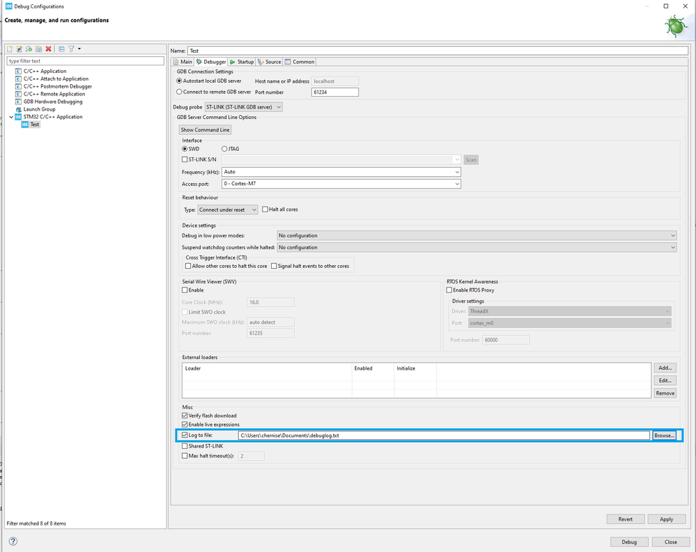

Hello @DRicc.2
Are you able to connect to the target the you get the error while executing the code. Or does the error popup when you try to start a debug session.
Could you provide the debug log for analysis?
To do so, go to the debug configuration check the "log to file" option then specifies the path where to save the log.

2023-05-12 7:15 PM
Not entirely sure where the reset options are, also tried to find the file output for the debug analysis, but cant find the menu you attached in the screen shot. I will try and use different pins instead to see if that changes anything. Also forgot to mention that it does upload in the sense that the first led will turn on at the top, but pushing the push buttons to turn on the other leds and turn off the ones in front doesn't work.
