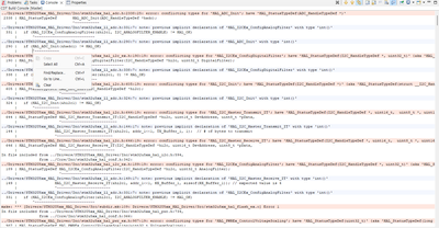

I am currently working on a project using an STM32U5 series microcontroller, and I have encountered a significant build issue with numerous errors related to the HAL driver.
Attached picture is just some of error code. (First and the last page)
It made1675 errors and 381 warnings.
I think my code doesn't have any problem becuase It worked well just few minutes ago.
Thank you.

I don't believe that's the full error list - I'm sure there must have been more errors before the start of that.
The full log would start with something like:
11:25:43 **** Build of configuration Debug for project nucleo-l073 ****
make -j8 all I'm afraid I can't find the post on where to find the full build log.

I think so too.
because if I re-build the project, the first line of the console change like attatched txt file.
but it still have same amounts of errors (1675 errors and 381 warnings.).
Also, I don't know the other way to capture all of errors.
( I think it's all... I "Select All" and copy paste it )
Thank you so much for your hard work

Certainly looks like you are missing needed header files.
I don't see any errors on failed #includes, so that must mean that you've failed put the necessary #include directives in your code.

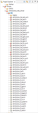

2024-04-05 4:12 AM
I included 4 header file above.
#include "main.h"
#include <stdio.h>
#include <stdint.h>
#include <string.h>and I don't think it's an iinclude issue, becasue other Slave file (which include same as Master project) work well.
and It work well with these 4 header file before :(

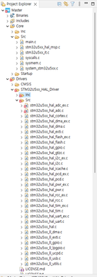

I captured Project Explorer, which shows some error.
I hope it could help to solve the problem..
thanks
