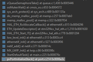

and the call stack when it hangs looks like this:
What I see is happening is:
any hints on how I can fix this? I've attacghed the empty project as *.7z file

I have the same problem that is represented in the capture, I get stuck at the same point. I have seen this problem in a nucleo-f439zi. I have tested also the cmsis os v2 and it doesn´t work either. This problem happened with the cmsis os v1. I think that the problem is because of a wrong configuration in LWIP or FreeRTOS.
