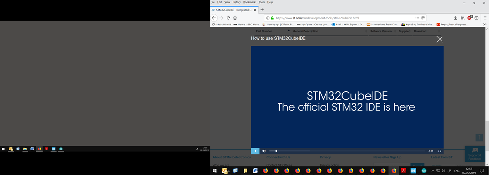

2019-05-02 4:54 AM
From their video
If it's the ~ OFFICIAL ~ STM32 IDE then I'd expect it to work and work well !!
I've tried every optimisation level and the best it can manage is
mul.w r2, r2, r3
adds r4, r4, r2
adc.w r5, r5, r2, asr #31
which of course is both inefficient and fundamentally wrong as it's thrown away active bits.
