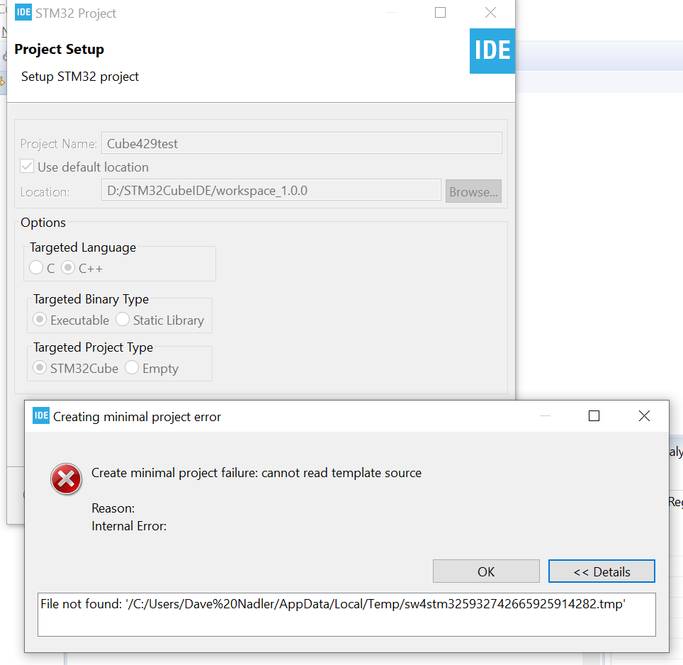

Just downloaded and installed STMcubeIDE 1.0.0 but it doesn't seem to work at all.
Tried to create a new project:
Fails as follows:
Any idea what's going on here?
Has anybody actually gotten this stuff to work?

%20 is a space, if I'm not mistaken? Is the user name Dave Nadler?
There's a ticket regarding the installation not working if installed into Program Files but I guess what is happening here is that project creation won't work with a space in the user name either and is generating a different kind of error.
2019-05-08 6:17 AM
Yes, user name has a space - as do many if not most Windows machines...
The installation default should be under "Program Files", not a c:\ST\... directory! Really!
I did a 2nd install using the non-standard C:\ST path but got the same error.
Are you able to verify that the blank in user name is the problem?
What's the plan to fix this (and the default installation location)?
Thanks!

In order to know for sure if it's the space or not, please test the following:
Please let me know the result after that. I tried setting up a test environment with a user with a space in its name but I don't get the error at all so I can't test it.

@Markus GIRDLAND - Now I can create a default C++ project, so failing on space within the Windows User Name may be the bug.
However: After making NO peripheral changes or doing anything in CubeMX perspective:
Where has the "Generate Code" button gone?
