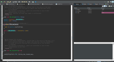

I am trying to toggle an led and in the debugger I am getting the error: "Break at address "XXXXXXX" with no debug information available, or outside of program code "; before the program ends itself. I've sourced the error back to the HAL_Delay, I think the HAL_GetTick is getting stuck in a infinite while loop and not updating

Perhaps show a full screenshot of STM32CubeIDE when the message comes up. Why do you think it's in HAL_Delay?

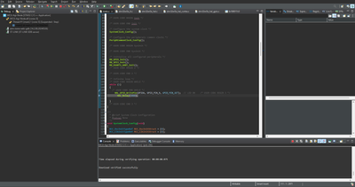

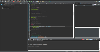

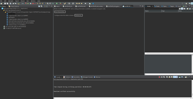

I just saw the PA10 thing, and have it pulled low right now. Here are screen shots of my debug in order

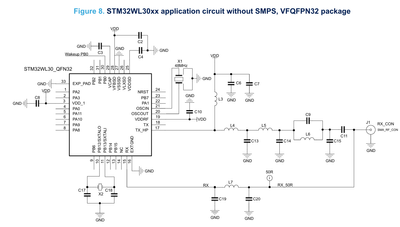

Power and decoupling caps hooked up according to the datasheet?

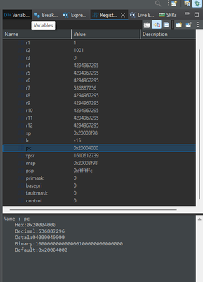

Looks kind of like an interrupt fired which pointed to erased memory, but that shouldn't really happen. You can look at VECTACTIVE field somewhere in SCB registers to see what interrupt it's in. Probably hard fault or something power related is my guess.

I currently have C2, C3, C4, C8, C10 connected and nothing else. VECTACTIVE said as 0x0 for the entire loop and then ends as 0x3 ... going to look up what it means, but posting this incase you find an issue

Subtract 16 from VECTACTIVE and look up in IRQn_Type. In this case, -13 is HardFault_IRQn. STM32CubeIDE has a hard fault analyzer.
Is GND hooked up to 13, 27, and exposed pad?
Edit: Look for something in your power scheme which is different from the example layouts.

It's hooked up to back pad, pins 27 and pin 16. fault analyzer doesn't give any info, is there a way to configure it?
