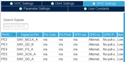

GPIO Settings :

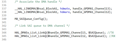

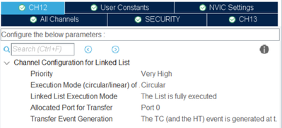

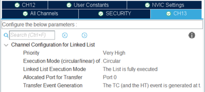

We set GPDMA1 channel12 and channel13 for SAI
In main() :

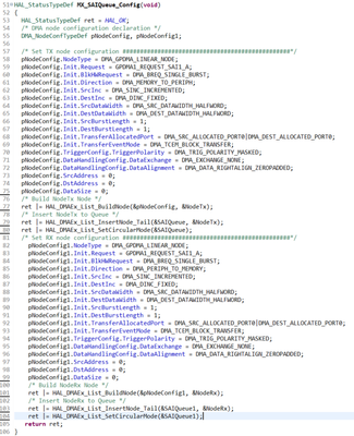

MX_SAIQueue_Config():
