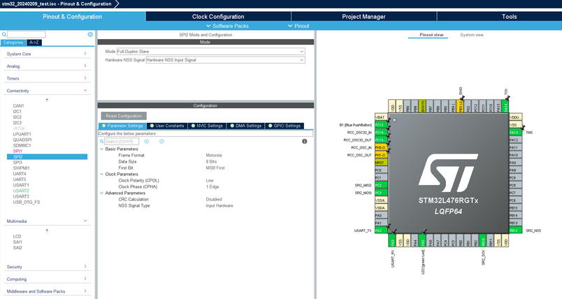

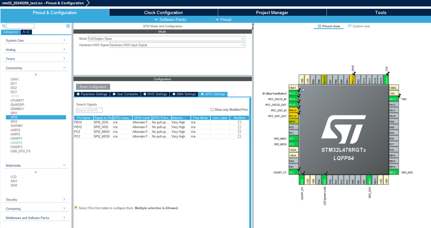

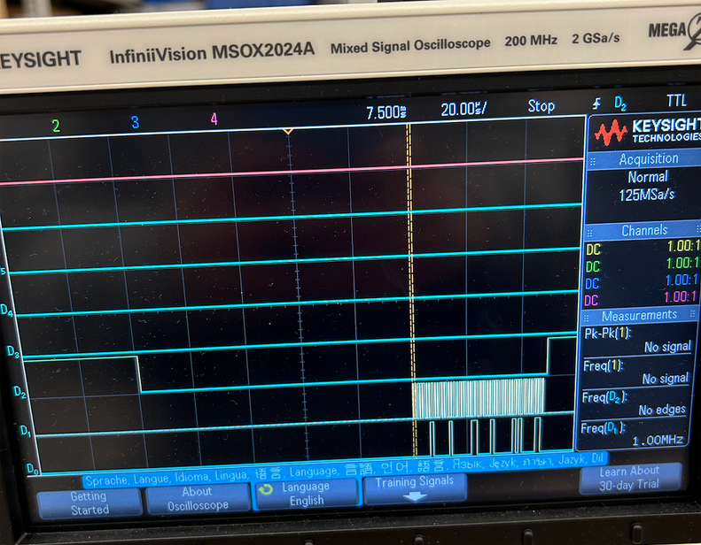

I'm working with an STM32L476RG board and attempting to set it up as a Full-Duplex SPI slave. My configuration in STM32CubeIDE seems correct, but I'm encountering an issue with receiving data. Attached are my STM32CubeIDE configuration screenshots and oscilloscope readings from the SPI master. (Master is sending out 6 bytes, "1, 2, 3, 4, 5, 6)The oscilloscope's D0, D1, and D2 channels are connected to PC3, PB10, and PB12, respectively. I believe my clock parameter settings are accurate.
