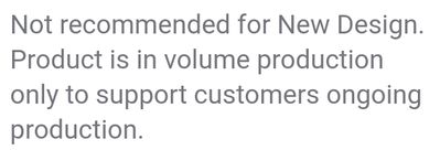

2023-09-11 7:07 PM - edited 2023-09-11 7:08 PM
One other thing, this product (ST25RU3993) is an NRND
that means that he is not recommended for new design.
That's why I suggest you to think about using a new one.
Best regards.
II
2023-09-12 6:00 PM
We purchase in bulk from the distributor, so we are not currently concerned about this issue. Thank you for the reminder.
