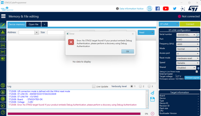

I just unchecked the option to not show me again that window(window for firmware upgrade) , now tried with Programmer I also can't connect. It even can't "see" the board as accessible, even tho it is powered on an control LEDs are blinking.
2024-02-21 7:50 AM
What message is showing with CubeProgrammer?
Could you please share a screenshot of the error?
2024-02-21 8:21 AM
2024-02-22 7:16 AM
Are you sure you didn't modify any option byte?
Are you sure you didn't make any HW change to the board?
2024-02-22 7:59 AM
I found a solution , it was a little switch on the board which switches beetwen SYS_MEM and FLASH. All it needs to be done is noted on here: https://community.st.com/t5/stm32cubeprogrammer-mcus/stm32h7b3i-dk-error-no-stm32-target-found/td-p/303802.
