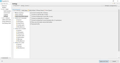

When you use an STM32H7 Dual Core board. You have the ability to generate a single binary file, containing the firmware for the cortex-M7 and the cortex-M4.
It is also possible to have two separated binary files for each core.
In order to generate a binary file, you ought to follow these steps:
In Cube IDE go to Project Settings --> C/C++ Build group --> Settings --> Tool Settings tab --> MCU Post build outputs --> Convert to binary file.
