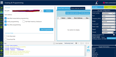

I need to flash both the cores of stm32h745zit3. Tried to flash the code using STMCube ide. But after reset pin pressed, cm4 is not getting run. Using ide i run both cores separately. And using programmer tried to load hex separately but it doesn't work. Are there any additional settings required?
Above is the settings used in programmer.
Thanks in advance
