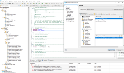

I'm using a NUCLEO-H723ZG and I've installed the CMSIS DSP library, but when I try to compile the code something goes wrong...
May you help me to understand what do I make wrong ?

Please do not use "libarm_cortexM7l_math.a",  "libarm_cortexM7lfdp_math.a" and"libarm_cortexM7lfsp_math.a".  This usage is not recommended as it can lead to side-effects in some use cases.
So from From Project menu or File menugo to Properties > C/C++ Build > Settings > Tool Settings > MCU CGC Linker > Libraries > Libraries (-l) > Add and insert the following library: "arm_cortexM7l_math", "arm_cortexM7lfdp_math" and "arm_cortexM7lfsp_math".
I advise you to follow the steps shared in this FAQ: Configuring DSP libraries on STM32CubeIDE - STMicroelectronics Community to add DSP on your project.
Thank you.
Kaouthar

Please try again by entering following parameters in Libraries (removing "lib" and ".a"):
arm_cortexlfsp_math
arm_cortexM7l_math
Please make sure the link to libraries are also correct.
