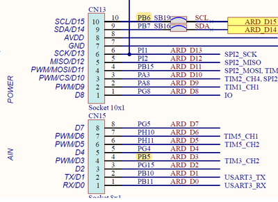

For CAN/FDCAN usage on any board you need to check if there is a CAN/FDCAN transceiver available on the board. If it is the case the board supports natively CAN communication (refer to the board’s user manual). If not you need to check if the CAN pins are exposed externally from the board to connect your own transceiver. If it’s not the case, the only config you can use is the loopback mode and normal mode is not available.
In your case I see one possibility to use FDCAN on this board by using FDCAN2 because the alternate functions (FDCAN2_Tx=PB6 and FDCAN2_Rx=PB5) are exported on Arduino connector to connect an external transceiver:
