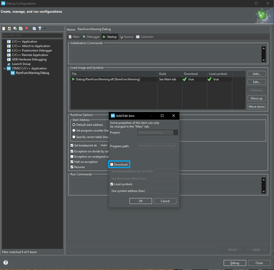

When starting a Debugging session, the STLink does not download the software onto the MCU, even though it should be enabled according to the debugging configuration. The CubeProgrammer that should run in the IDE does not start (according to the gdbserver logs).

I also tried flashing the software using STM32CubeProgrammer and then starting the debug session with software download disabled. The MCU run the software and I could pause it, but breakpoints did not work. When I then tried resetting the MCU with the IDE, I got the situation described before.

- Either use OpenOCD for debug
- Or flash the elf file using the STM32CubeProgrammer standalone and configure the debugger in STM32CubeIDE to just load the symbols.
