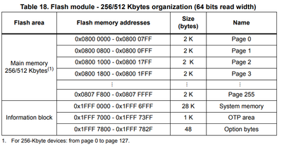

For my project I use a stm32g491rct6 with 256k flash. RM0440 Reference manual table 2 say that the flash of this Micro is 256KB in single bank, at this point what is the page size and flash mapping? In stm32g4xx_hal_flash.h FLASH_PAGE_SIZE is 0x800U /* 2 KB */ and bit22 in User option bytes is SET .

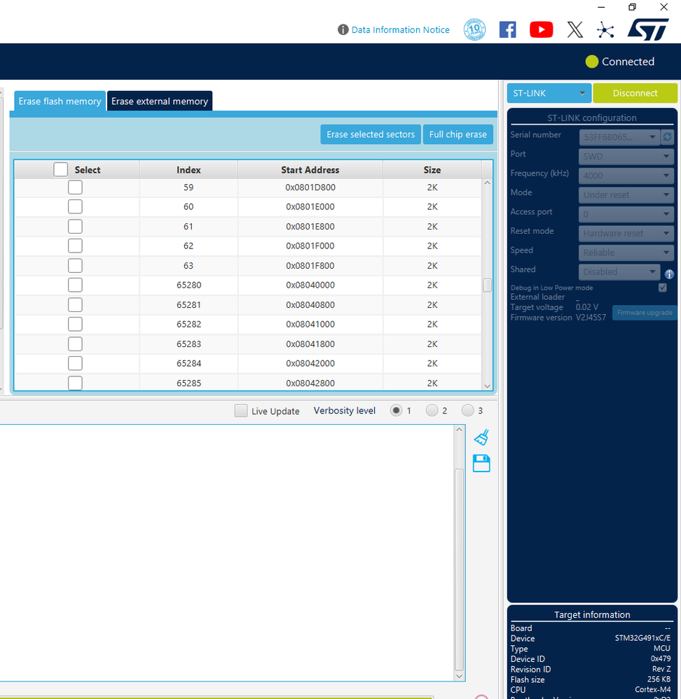

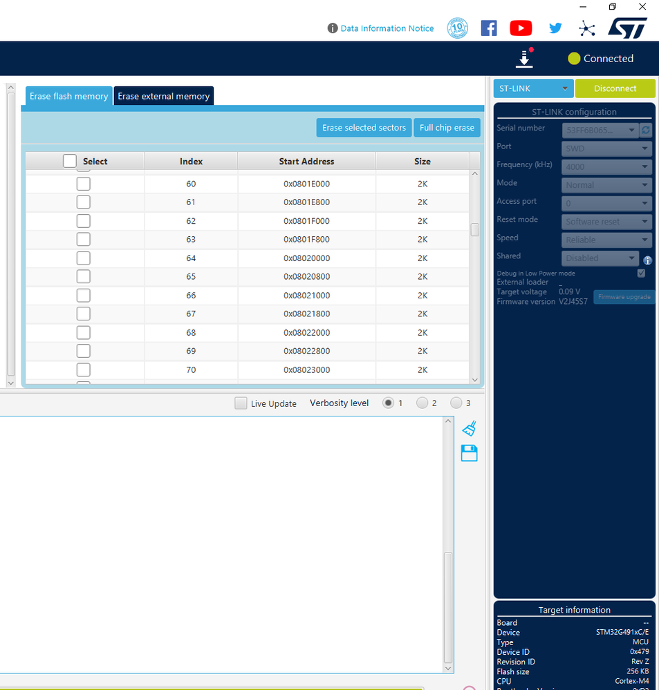

Cubeprogrammer 2.16.0 show the block contiguos 0-255 from 8000000 to 807ffff while Cubeprogrammer 2.17.0 show blocks 0-63 from 8000000 to 801ffff and 65280-65343 from 8040000 to 805ffff.

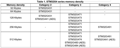

The STM32G491 belongs to category 4.
So, the size is 2 Kbyte as mentioned in RM0440 table 18
Also, I advise you to refer to  STM32 MCU reference manuals: Expected preliminary ... - STMicroelectronics Community for some FLASH typos in RM0440
