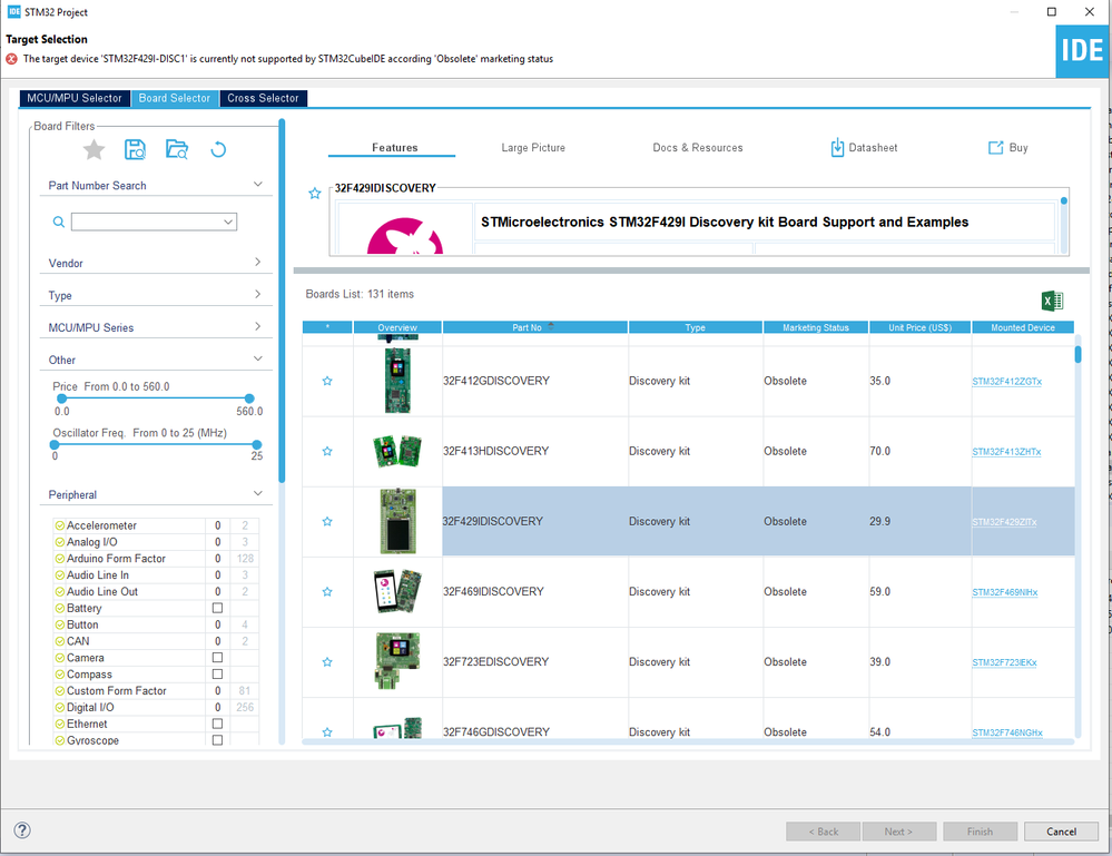

I just wanted to create a new project for the board ( last project I created about 24 hours ago, was still working ). That caused an update to run, the device is now obsolete, and I can't create projects, get the error: The target device 'STM32F429I-DISC1' is currently not supported by STM32CubeIDE according 'Obsolete' marketing status
As of now, the status on https://www.st.com/en/evaluation-tools/32f429idiscovery.html is still ACTIVE. What is that, and how can it be fixed urgently?

IBret
Associate II
Update....ALL development boards are marked as Obsolete!

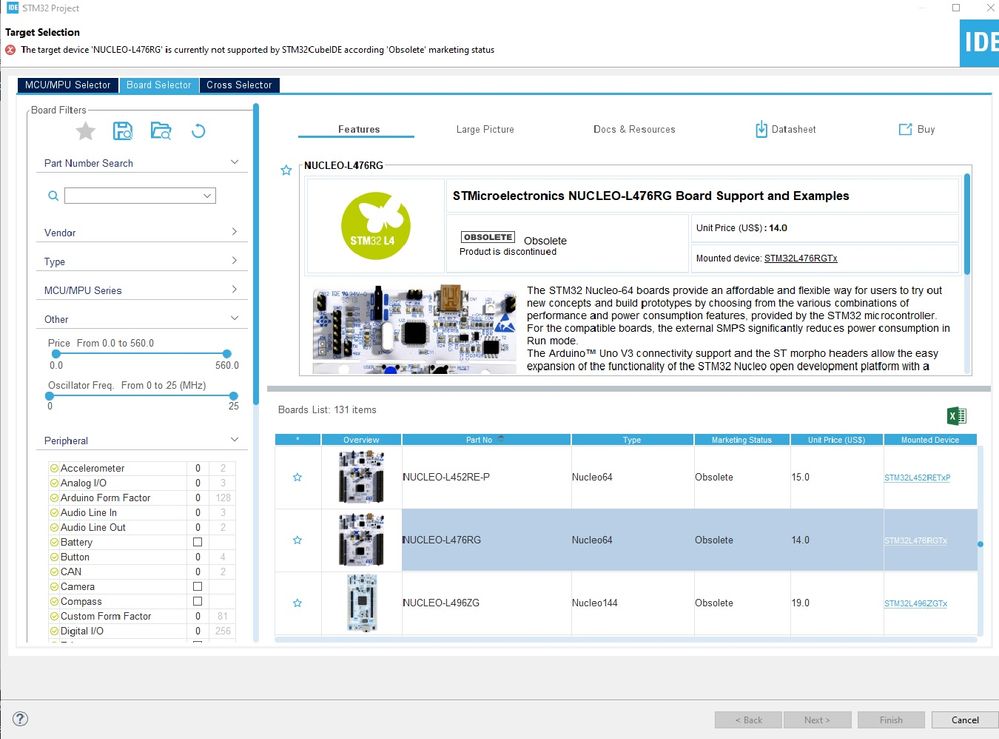

IBret
Associate II
All development boards became obsolete....very much looks like a bug.0690X00000ARTWHQA5.png
0690X00000ARTZuQAP.jpgSame experience here. I attended an ST workshop 2 days ago and got this board. This board cannot be obsolete, in reality. Has to be a bug.
I tried uninstall and re-install of STM32CubeIDE - got same result.
I pulled out my laptop from the workshop, and disabled the wi-fi before running STM32CubeIDE. Similarly to in the workshop (where there was a very slow wi-fi) - at the time of "Initializing target selector" it asked if I wanted to set up an internet connection. I said no. In this laptop instance, the NUCLEO-L476RG board is in active mass production.
The apparent conclusion is that the target selector performs a transparent update if STM32CubeIDE has an established connection when it's executed.
I'll confirm this in a few - have to drop internet to try it.
